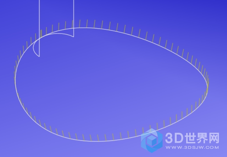

[求助] 同样的四轴后处理,只是旋转方向变了,生成的程宇就不一样

一个正转,一个反转

是程序模拟器的问题吗

肯定是四轴啊
G40 G80 G17 G49
G91 G28 Z0.0
M01
( DJ-D6  D=6.00 R=0.00 )
N0010 T02 M06
G00 G90 G54 X11.669 Y-1.043 A0.0 S4000 M03
G43 Z23.51 H02
Z19.91
G01 Z16.353 F200.
G02 X10.713 Y-.044 R1.
G01 X10.714 Y0.0
X10.728 Z16.352 A-1.129
X10.77 Z16.348 A-2.244
X10.84 Z16.341 A-3.34
X10.936 Z16.332 A-4.42
X11.059 Z16.321 A-5.475
X11.207 Z16.308 A-6.49
X11.377 Z16.294 A-7.459
X11.569 Z16.278 A-8.385
X11.784 Z16.261 A-9.264
X12.016 Z16.244 A-10.08
X12.264 Z16.227 A-10.83
X12.528 Z16.21 A-11.516
X12.808 Z16.193 A-12.138
X13.1 Z16.178 A-12.682
X13.4 Y-.03 Z16.164 A-13.251
X13.708 Y0.0 Z16.152 A-13.531
X14.025 Z16.142 A-13.834
X14.349 Z16.135 A-14.055
X14.674 Z16.13 A-14.187
X14.999 Z16.129 A-14.229
X15.326 Y-.062 Z16.13 A-14.406
X15.654 Y0.0 Z16.135 A-14.054
X15.975 Z16.142 A-13.833
X16.291 Y-.008 Z16.152 A-13.561
X16.601 Y-.03 Z16.164 A-13.251
X16.904 Y-.063 Z16.178 A-12.899
X17.195 Y0.0 Z16.193 A-12.132
X17.472 Z16.21 A-11.516
X17.737 Z16.227 A-10.827
X17.988 Z16.244 A-10.069
X18.22 Z16.261 A-9.25
X18.432 Z16.278 A-8.381
X18.624 Z16.294 A-7.458
X18.795 Z16.308 A-6.48
X18.942 Z16.321 A-5.462
X19.064 Z16.333 A-4.416
X19.16 Z16.341 A-3.342
X19.23 Z16.348 A-2.239
X19.272 Z16.352 A-1.118
X19.286 Z16.353 A.004
X19.272 Z16.352 A1.122
X19.23 Z16.348 A2.239
X19.16 Z16.341 A3.347
X19.063 Z16.332 A4.424
X18.941 Z16.321 A5.47
X18.794 Z16.308 A6.486
X18.622 Z16.294 A7.464
X18.43 Z16.278 A8.389
X18.217 Z16.261 A9.259
X17.985 Z16.244 A10.076
X17.735 Z16.227 A10.833
X17.47 Z16.209 A11.522
X17.192 Y.001 Z16.193 A12.139
X16.902 Y.063 Z16.178 A12.901
X16.6 Y0.0 Z16.164 A13.147
X16.289 Y.008 Z16.152 A13.563
X15.973 Y0.0 Z16.142 A13.837
X15.653 Z16.135 A14.054
X15.327 Z16.13 A14.187
X14.998 Y.025 Z16.129 A14.321
X14.671 Y.063 Z16.13 A14.408
X14.347 Y-.001 Z16.135 A14.052
X14.025 Y0.0 Z16.142 A13.834
X13.707 Y.008 Z16.152 A13.559
X13.397 Y.03 Z16.164 A13.248
X13.097 Y.063 Z16.178 A12.899
X12.806 Y0.0 Z16.193 A12.133
X12.525 Z16.21 A11.51
X12.261 Z16.227 A10.821
X12.013 Z16.244 A10.07
X11.781 Z16.261 A9.253
X11.567 Z16.278 A8.375
X11.374 Z16.294 A7.446
X11.205 Z16.308 A6.477
X11.058 Z16.321 A5.466
X10.936 Z16.333 A4.413
X10.839 Z16.342 A3.33
X10.77 Z16.348 A2.234
X10.728 Z16.352 A1.125
X10.714 Z16.353 A0.0
X10.713 Y.044
G02 X11.669 Y1.043 R1.
G01 Z19.91
G00 Z23.51
M05
M09
G91 G28 Z0.0
G91 G28 Y0.
M30
