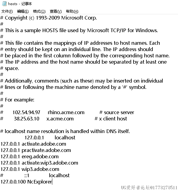

电脑从win7 32位系统换成win7 64位后,电脑可以连接机床,但不能查看机床上的文件。点开图标后弹出FTP文件夹错误小窗口,窗口显示:“Windows 无法访问此文件夹。请确保输入的文件名是正确的,并且您有权访问此文件夹。   详细信息:无法解析服务器的名称或地址”

你直接输入ftp://192.168.1.201

或者\\192.168.1.201

把C:\Windows\System32\drivers\etc\hosts文件里面的代码弄成这样,可以新建一个文件,把下面代码#开始的代码复制进去,然后去掉文件的后缀名放进前面的路径也可以。完整代码:# Copyright (c) 1993-2009 Microsoft Corp. # # This is a sample HOSTS file used by Microsoft TCP/IP for Windows. # # This file contains the mappings of IP addresses to host names. Each # entry should be kept on an individual line. The IP address should # be placed in the first column followed by the corresponding host name. # The IP address and the host name should be separated by at least one # space. # # Additionally, comments (such as these) may be inserted on individual # lines or following the machine name denoted by a '#' symbol. # # For example: # #      102.54.94.97     rhino.acme.com          # source server #       38.25.63.10     x.acme.com              # x client host  # localhost name resolution is handled within DNS itself.         127.0.0.1       localhost 127.0.0.1 activate.adobe.com 127.0.0.1 practivate.adobe.com 127.0.0.1 ereg.adobe.com 127.0.0.1 activate.wip3.adobe.com 127.0.0.1 wip3.adobe.com #        ::1             localhost 127.0.0.100 NcExplorer

找到C:\Windows\System32\drivers\etc\hosts文件用记事本打开如下图,没有就重新建文本去掉后缀名。# Copyright (c) 1993-2009 Microsoft Corp.
# space.
# For example:
        127.0.0.1       localhost
#        ::1             localhost
