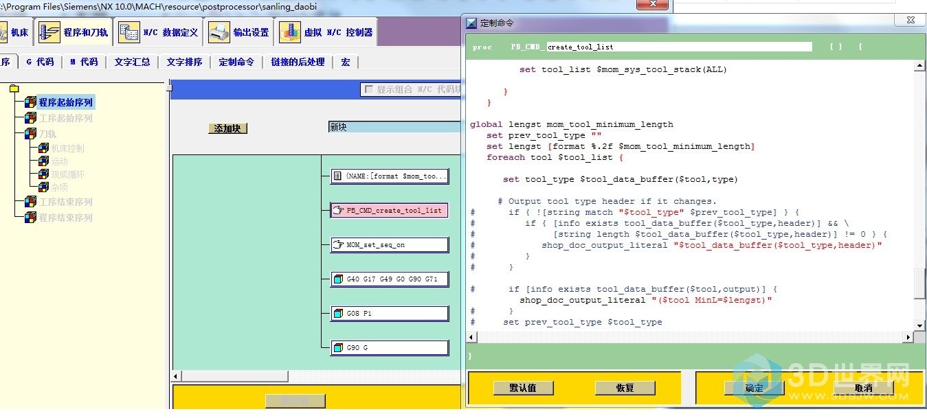

下面是我改的后处理,我希望刀具列表信息把最短刀长带入。请问如何才能捕获最短刀长?
global lengst mom_tool_minimum_length
   set prev_tool_type ""
   set lengst [format %.2f $mom_tool_minimum_length]
   foreach tool $tool_list {
      set tool_type $tool_data_buffer($tool,type)
     # Output tool type header if it changes.
#      if { ![string match "$tool_type" $prev_tool_type] } {
#         if { [info exists tool_data_buffer($tool_type,header)] && \
#              [string length $tool_data_buffer($tool_type,header)] != 0 } {
#            shop_doc_output_literal "$tool_data_buffer($tool_type,header)"
#      if [info exists tool_data_buffer($tool,output)] {
         shop_doc_output_literal "($tool MinL=$lengst)"
#     set prev_tool_type $tool_type

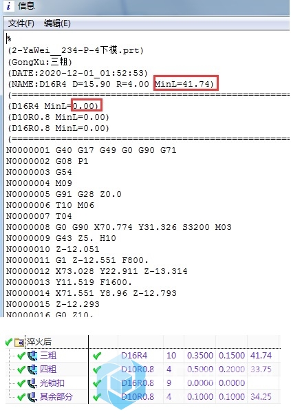

后处理出来实际情况如下:
(2-YaWei__234-P-4下模.prt)
(GongXu:三粗)
(DATE:2020-12-01_01:52:53)
(NAME:D16R4 D=15.90 R=4.00 MinL=41.74)
(D16R4 MinL=0.00)
(D10R0.8 MinL=0.00)
(D16R0.8 MinL=0.00)
N0000001 G40 G17 G49 G0 G90 G71
