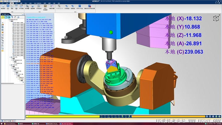

  (3).五轴联动程序范例:
     G17 G40 G94 G49 G80 G90 G69
     T1 M6
     (刀具: D16R0.8 D=16 R=0.8 L=75)
     M82 (A轴松开)
     M84 (C轴松开)
     G0 G90 G54 S8000 M3
     G68.2 X0. Y0. Z0. I90. J30. K180. (计算工件的初始姿态)
     G53.1 (工件旋转刀初始姿态)
     G0 X5.137 Y9.55 (XY方向移动刀具)
     G43 Z74.657 H2  (Z轴方向移动刀具到工件表面)
     G49 (取消G43)
     G69 (取消G68.2)
     G43.4 H2 M8 (开启刀尖跟随RTCP)
     G0 X45.599 Y-5.137 Z59.88
     X12.05 Z1.77
     G1 X16.38 Y-5.068 Z-.729 F2000.
     X17.058 Y-5.006 Z-1.121
     X17.718 Y-4.812 Z-1.502
     X18.343 Y-4.501 Z-1.863
     X18.919 Y-4.081 Z-2.195
     X19.43 Y-3.562 Z-2.49
     X19.865 Y-2.958 Z-2.742
     X20.213 Y-2.282 Z-2.942
     X20.465 Y-1.551 Z-3.088
     X20.615 Y-.784 Z-3.174
     X20.65 Y0. Z-3.195
     X20.64 Y.655 C271.819
     X20.607 Y1.331 C273.695
     X20.55 Y2.026 C275.631
     X20.467 Y2.741 C277.628
     X20.355 Y3.475 C279.688
     X20.467 Y-2.741 C262.372
     X20.55 Y-2.026 C264.369
     X20.607 Y-1.331 C266.305
     X20.64 Y-.655 C268.181
     X20.65 Y0.0 C270.
     X20.615 Y.784 Z-3.174
     X20.465 Y1.551 Z-3.088
     X20.213 Y2.282 Z-2.942
     X19.865 Y2.958 Z-2.742
     X19.43 Y3.562 Z-2.49
     X18.919 Y4.081 Z-2.195
     X18.343 Y4.501 Z-1.863
     X17.718 Y4.812 Z-1.502
     X17.058 Y5.006 Z-1.121
     X16.38 Y5.068 Z-.729
     X12.05 Y5.137 Z1.77
     G0 X45.599 Z59.88 M9
     G49 M5 (关闭刀尖跟随RTCP)
     G91 G28 Z0.
     G28 A0. C0.
     G28 X0. Y0.
     M30

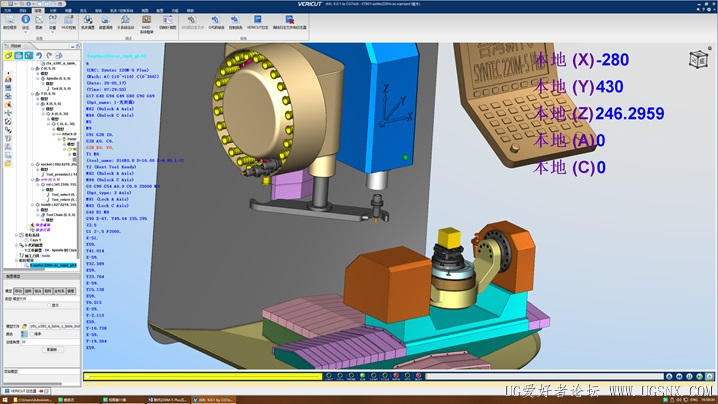

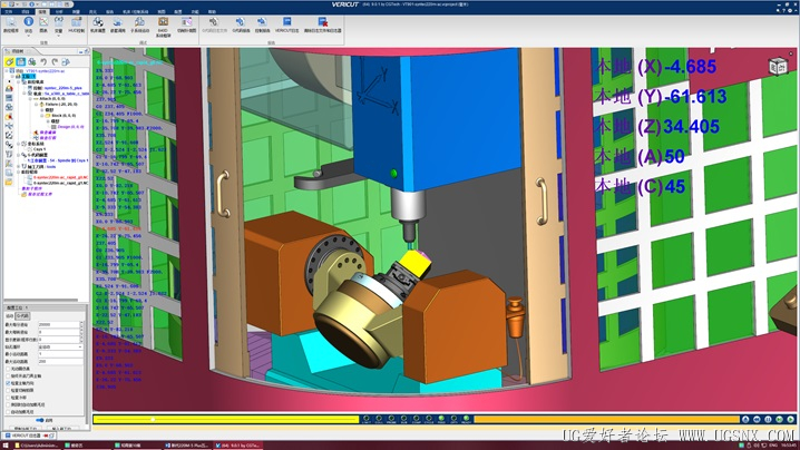

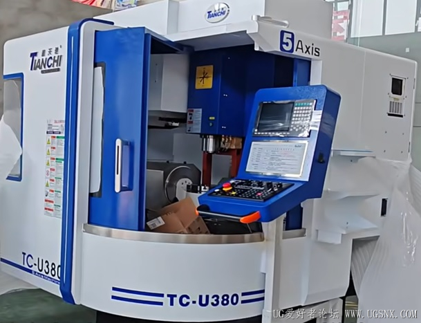

鸿天驰U380机床
鸿天驰U380机床
用VERICUT搭建U380机床模型
用VERICUT搭建U380机床模型
VERICUT换刀子程序验证
VERICUT换刀子程序验证
刀尖跟随RTCP验证
刀尖跟随RTCP验证

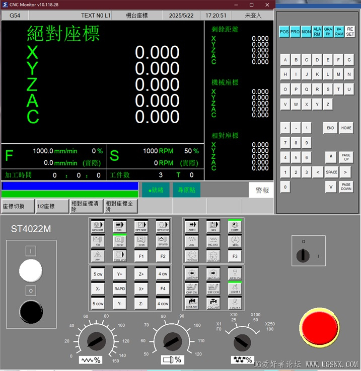

新代220M-5五轴模拟器
新代220M-5五轴模拟器
