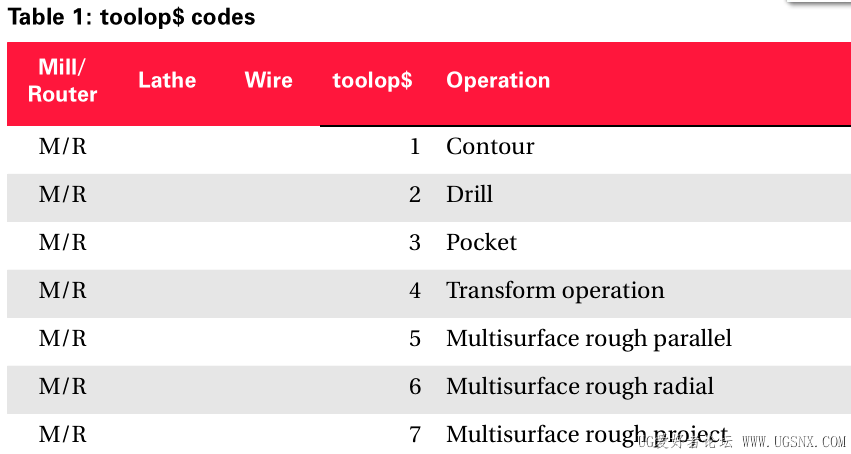

if tool_op$ <> 2 & tool_op$ <> 11 & tool_op$ <> 28 & tool_op$ <> 104 & tool_op$ <> 136 & tool_op$ <> 114 & tool_op$ <> 19 ,
2,11,28,104,136,114,19,分别代表什么?

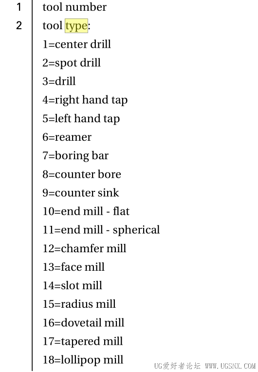

if tool_typ$ = 3 | tool_typ$ = 4 | tool_typ$ = 5 | tool_typ$ = 6 | tool_typ$ = 7,
3,4,5,6,7,分别代表什么?

发表于 2026-3-3 15:35:43 | 显示全部楼层
1 Contour
2 Drill
3 Pocket
4 Transform operation
5 Multisurface rough parallel
6 Multisurface rough radial
7 Multisurface rough project
8 Multisurface rough flowline
9 Multisurface rough contour
10 Multisurface rough pocket
11 Multisurface finish parallel
12 Multisurface finish radial
13 Multisurface finish project
14 Multisurface finish flowline
15 Multisurface finish contour
16 For C-Hook- created operations
17 Manual entry
18 Circle mill
19 Point
20 Trimmed
21 Ruled
22 Revolved
23 Letters
24 Swept 2D
25 Swept 3D
26 Coons
27 Lofted
28 5-axis drilling. This value has been deprecated as of Mastercam 2020, since this toolpath is no longer a separate type in Mastercam. Drill toolpaths with 3-axis output use value 2 as of Mastercam 2020, while drill toolpaths with 4- or 5-axis output continue to use 28.
29 5-axis curve
30 Project toolpath onto a plane
31 Project toolpath onto a cylinder
32 Project toolpath onto a sphere
33 Project toolpath onto a cone
34 Project toolpath onto a cross section
35 Project toolpath onto a surface
36 Non-associative contour
37 Non-associative drilling
38 Non-associative pocketing
39 Multisurface finish pencil trace
40 Multisurface finish leftover stock
41 Multisurface finish steep
42 Multisurface finish shallow
43 Multisurface finish constant scallop
44 Multisurface rough plunge
45 Multisurface finish 5-axis flowline
46 Multisurface finish 4-axis
47 Merged in ASCII NCI
48 5-axis swarf
49 5-axis roll die
100 Thread mill
101 Edit common operation parameters
102 Facing
103 Associative trimmed
104 Solid drill control operation
105 Slot mill
106 Helix bore
107 Multi-surface rough restmill
108 Associative nesting container operation
109 Multi-surface finish blend
110 Multi-surface 5-axis, rough
111 Slice 5-axis
112 Port 5-axis
113 5-axis circle. This value has been deprecated as of Mastercam 2020, since this toolpath is no longer a separate type in Mastercam. Circle mill toolpaths with 3-axis output use value 18 as of Mastercam 2020, while circle mill toolpaths with 4- or 5-axis output continue to use 113
114 Advanced drill
115 Chamfer drill
130 Tab cutoff
131 Multi-surface rough pocket, light
132 High-speed surface toolpaths
133 Nesting onionskin operation
134 2-D hardmill machining/peel mill
135 Saw
136 FBM drill control operation
137 FBM mill pocket operation
138 FBM mill contour operation
139 Solid model operation
140 2D model chamfer
150 Probe cycle: probe motion
151 Probe cycle command block
152 Probe cycle header
153 Probe cycle trailer
154 SafetyZone linking or multiaxis linking operation
155 SafetyZone for multiaxis drill operation (only used for link_op$)
301 Router contour (obsolete)
302 Router pocket (obsolete)
303 Router circmill (obsolete)
304 Router cutoff (obsolete)
305 Router surface rough pocket (obsolete)
306 Block drill
416 Engraving
439 Art
440 (obsolete)
Note: For Mastercam X9 and earlier, 440 was used for any advanced multiaxis toolpath. Beginning with Mastercam 2017, individual codes are output for each type of operation as listed below, and 440 is no longer output.
441 Advanced multiaxis—swarf
442 Advanced multiaxis—morph
443 Advanced multiaxis—parallel
444 Advanced multiaxis—along curve
445 Advanced multiaxis—triangular mesh
446 Advanced multiaxis—roughing
447 Advanced multiaxis—project
448 Convert to 5-axis
449 Port Expert
450 Blade Expert
451 Rotary advanced
459 Deburr
460 3+2 automatic roughing
461 Unified multiaxis milling
462-469 Reserved
470 3-axis deburr

 楼主| 发表于 2026-3-2 11:49:12 | 显示全部楼层
非常感谢   请问这是在哪里可以查到?我还需要把剩下的查出来

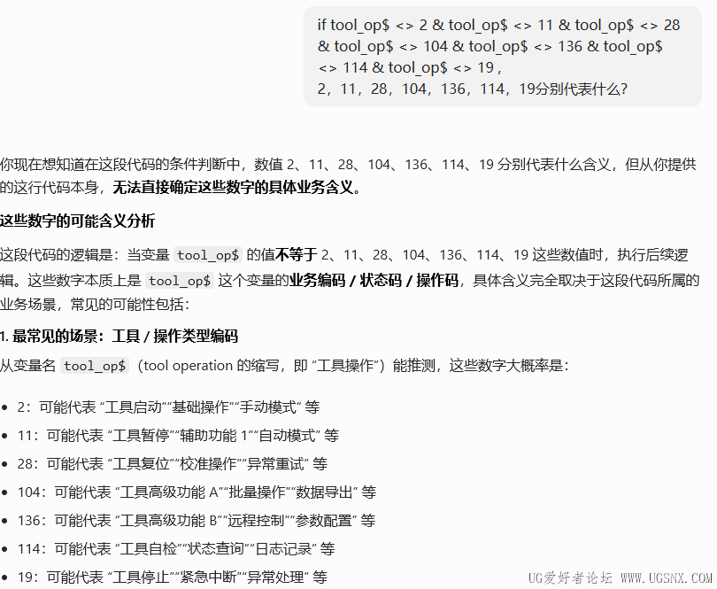

发表于 2026-3-2 12:00:47 | 显示全部楼层
回帖奖励 +2 G币
不如问问神奇的豆包

 楼主| 发表于 2026-3-2 13:34:48 | 显示全部楼层
qingxiansen1 发表于 2026-3-2 12:00
不如问问神奇的豆包
这回答的确实神奇 怕是所有AI中垫底了
