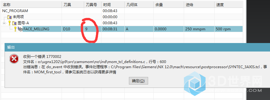

[已解决] 刀号设置成9,后处理报错
189
3408
3408
发表于 2020-5-22 02:04:02 | 显示全部楼层 |阅读模式
报错日志
***** A TCL Error Has Occurred *****
Event Handler: C:\Program Files\Siemens\NX 12.0\mach\resource\postprocessor\SYNTEC_3AXIS.tcl
Event: MOM_first_tool
Error Info: expected floating-point number but got "09" (looks like invalid octal number)
    while executing
"format "%02.0f" $mom_tool_number"
    (procedure "PB_CMD_tool_list" line 48)
    invoked from within
"PB_CMD_tool_list"
    (procedure "MOM_first_tool" line 25)
    invoked from within
"MOM_first_tool"
Error Code: TCL VALUE NUMBER
后处理文件
Desktop.rar (62.17 KB, 下载次数: 49)
请大神赐教

谢谢,刚找到原因了创建刀具列表的一段代码有问题

发表于 2020-7-14 15:05:39 | 显示全部楼层
将 set mom_tool_number [format "%02.0f" $mom_tool_number] 这行删除就正常了。
