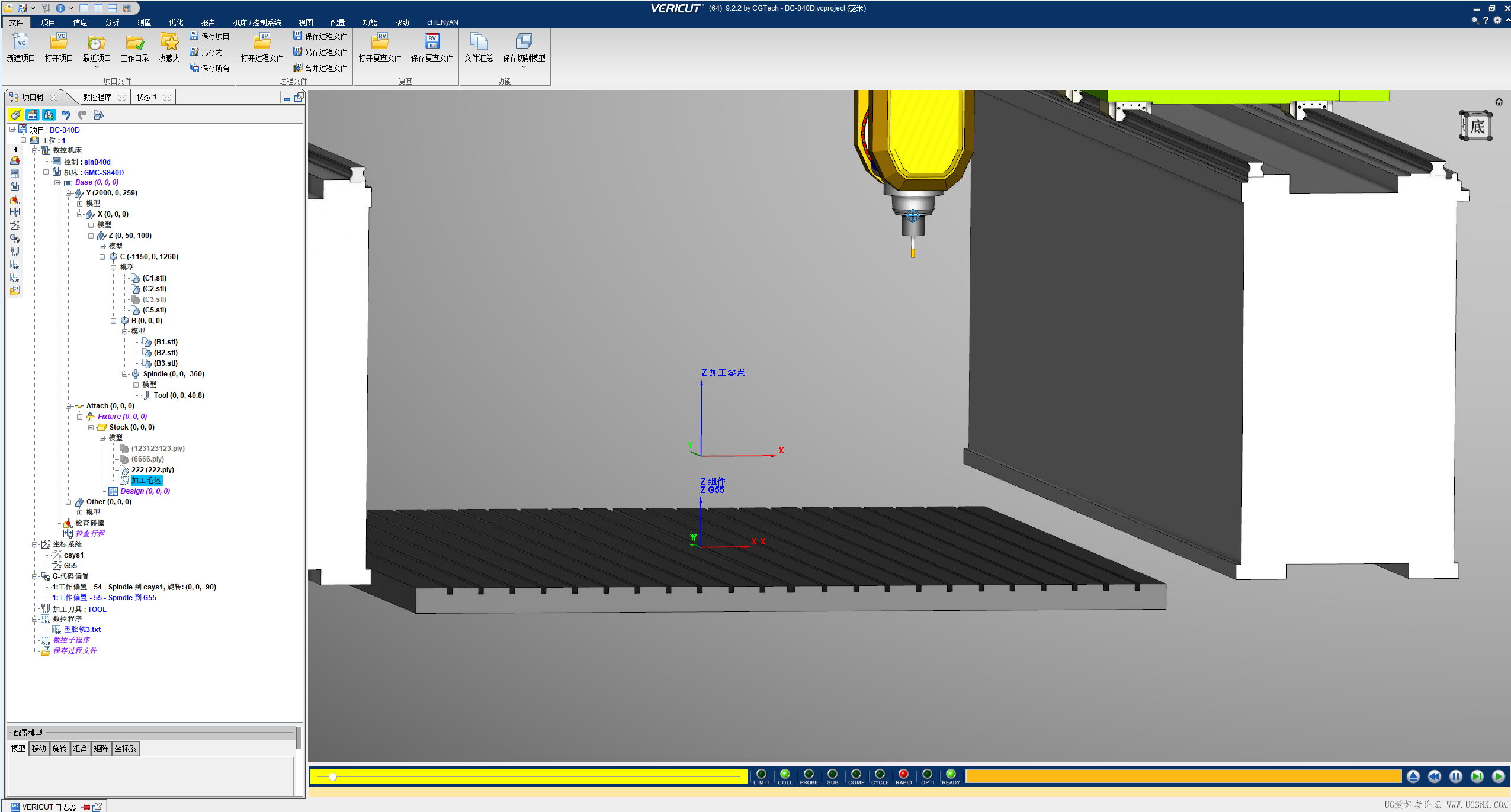

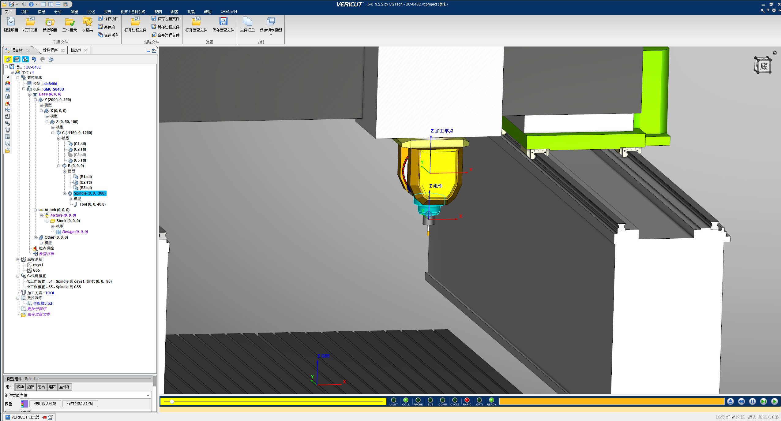

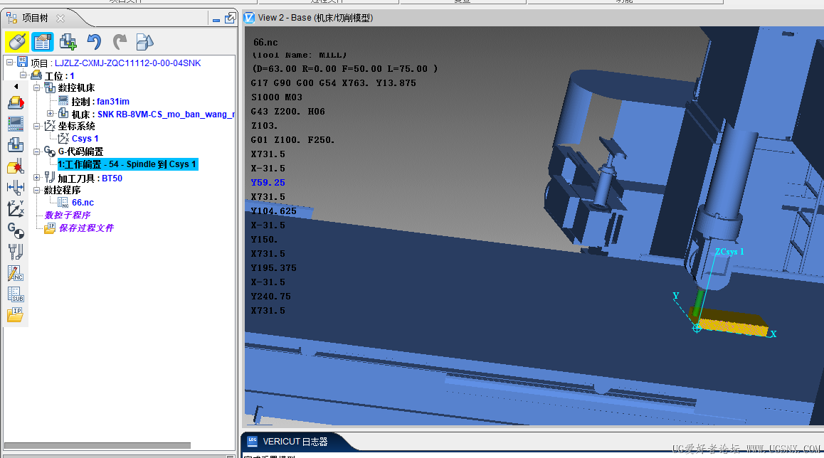

各位老师们,最近在搭双摆头机床模板的时候我发现一个问题,好像在创建的时候加工零点坐标系附着到了C轴组件上,而不是附着到主轴组件,这样好像会有一个偏置。然后在设置G54的时候,设置从Spindle组件到G54坐标系的时候在实际走G54的代码时加工零点坐标系也不会到G54上,仍然会保留这个主轴到C轴的偏置。感觉应该是初始的配置某一块没改过来,这个情况该怎么改比较合适?
初始设置的时候发现加工零点坐标系在C轴上:
跑G55的时候:
我感觉应该是某一个初始设置没设对,有没有哪位老师能跟我说一下该怎么改
明白你的意思,看我这个是不是你要的效果

 楼主| 发表于 2025-6-26 10:32:01 | 显示全部楼层
下一个三毛* 发表于 2025-6-25 15:34
明白你的意思,看我这个是不是你要的效果
对 老哥,就是这个,我把C改成Spindle,但是在模型上面那个加工零点坐标系没跟着变,还是在C轴上。我现在是在已经有的案例上面改我自己的模板,这样改好像是正常的。

 楼主| 发表于 2025-6-30 16:58:34 | 显示全部楼层
我查了一下VERICUT的论坛,好像这种情况不是BUG,在定义的时候如果工件端存在两个旋转轴,DrivenPoint会被自动定义到两个旋转轴的交点上。
Driven Point Zero — When toggled "On", displays the "driven point" (identified by the
target symbol) and the XDrivenPointYDrivenPointZDrivenPoint axes.
The "driven point" is only displayed in the Machine View. Depending on the machine
configuration, more than one Driven Point Zero axis may be displayed in the View Axes
window as shown in the picture above.
The initial "driven point" position is determined based on the following:
• If there are no rotary/turret components attached to the "active" tool component,
the initial driven point is the origin of the "active" tool component.
• If there is 1 rotary/turret component attached to the "active" tool component, the
initial driven point is the origin of the rotary/turret component.
• If there are 2 rotary/turret components attached to the "active" tool component,
the initial driven point is the intersection of the two rotary axes.
• If there are more than 2 rotary/turret components attached to the "active" tool
component, the initial driven point is the origin of the highest level rotary/turret
component.
To see the complete description in the Help files go the the View menu, View Axes...,
then press F1.  This will open the Help on this window which includes the Driven Point Zero
I'm not sure what your second comment means "Also I don't have any tool loaded project file."
Do you mean your tools don't load or you can't see your tools in the Machine View?  If this is
the case make sure your tools have a Gage Point value so that they don't load up inside the
spindle.  VERICUT uses the location of the Gage Point of the tool to "load" the cutter at the
origin of the tool component on the machine.
