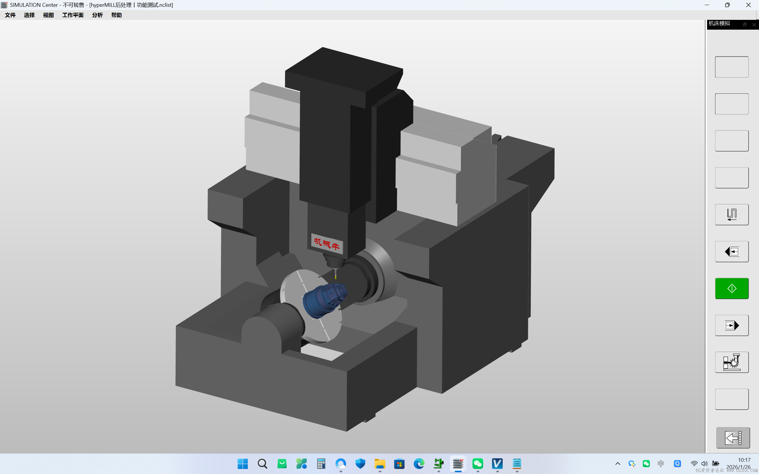

发表于 2026-1-26 10:42:59 | 显示全部楼层 |阅读模式
FANUC_31i_MODEL_B5_5X_TabBC.rar (66 KB, 下载次数: 232)
O0001
N1 ( - TEL : XXX )
N2 ( - M/T : TabBC )
N3 ( - CTL : FANUC 31i-MODEL B5 )
N4 ( - TOOL_LIST_STR )
N5 ( - T01 D10-XD-40 D=10 R=0 L=40 C=30 HSK63A-SRS10-085TRN )
N6 ( - TOOL_LIST_END )
N7 ( - OPERATION 1 )
N8 ( - D10-XD-40 )
N9 G40 G49 G80
N10 M06 T01
N11 G0 G90 G53 Z0.
N12 M10 (R1 UNLOCK)
N13 M12 (R2 UNLOCK)
N14 G0 G90 B0 C0
N15 M03 S8356
N16 G0 G90 G53 Z0.
N17 G69
N18 G49
N20 G54
N21 G90
N22 G05.1 Q1
N23 M10 (R1 UNLOCK)
N24 M12 (R2 UNLOCK)
N25 G0 B-53.04 C187.9
N26 G68.2 X106.435 Y2.614 Z-4.423 I97.9 J53.04 K180.
N27 G53.1
N28 G0 X0 Y0
N29 G69
N30 G43.4 H01
N31 G0 X106.435 Y2.614 Z-4.423 M08
N32 G0 X70.112 Y2.614 Z-40.746 B-53.04 C187.9
N33 G1 X66.155 Y2.065 Z-43.752 F1228.
N34 G1 X65.978 Y3.022 Z-43.972 F1228.
N35 G1 X65.802 Y3.979 Z-44.192
N359 G1 X63.753 Y7.376 Z-41.547
N360 G0 X67.631 Y7.915 Z-38.601
N361 G0 X104.122 Z-2.11
N362 G05.1 Q0
N363 ( - OPERATION 2 )
N364 ( - D10-XD-40 )
N365 G49
N366 G0 G90 G53 Z0.
N367 G69
N368 G54
N369 G90
N370 M10 (R1 UNLOCK)
N371 M12 (R2 UNLOCK)
N372 G0 B-90. C90.
N373 G68.2 X0. Y-86.603 Z-92. I0. J90. K0.
N374 G53.1
N375 M11 (R1 LOCK)
N376 M13 (R2 LOCK)
N377 G05.1 Q1
N378 M03 S8356
N379 G0 X14.991 Y52.837
N380 G0 G43 H1 Z50. M08
N381 G0 Z-16.403
N382 G1 X15.122 Y52.783 Z-16.603 F1228.
N383 G1 Z-21.403
N384 G1 G41D1 X16.046 Y53.166 F1228.
N396 G3 X9.929 Y54.19 Z-21.403 I0.499 J-7.41
N397 G1 G40
N398 G1 X10.383 Y53.299
N399 G1 Z-16.603
N400 G0 Z50.
N401 G05.1 Q0
N402 G49
N403 G69
N404 M09
N405 M05
N406 G0 G90 G53 Z0.
N407 G0 G90 G53 Y0.
N408 M10 (R1 UNLOCK)
N409 M12 (R2 UNLOCK)
N410 G0 G90 B0 C0
N411 ( - MACHINING TIME: 0:00:13 )
N412 M30

发表于 2026-1-27 09:34:32 | 显示全部楼层
这个后处理不对,后处理不出来东西。
82
82
 楼主| 发表于 2026-1-27 18:53:54 | 显示全部楼层
UHICE 发表于 2026-1-27 09:34
这个后处理不对,后处理不出来东西。
后处理放置的位置路径,不可以有中文、标点符号、空格,只可以有英文和阿拉伯数字
