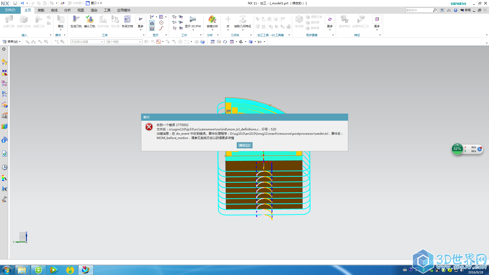

为什么用不了

O0001
(MILL                 D          R          L          )
(T1==D10              10.000     0.000      50.000     )
(T1==D12              12.000     0.000      50.000     )
(NC-Dir==D:\o1.ptp)
(Part-Dir: C:\temp\_model1.prt)
(Time: Wed Sep 28 09:42:26 2016)
(BBS:www.ugsnx.com)
(Writer: Mr.liang)
G21
G17 G40 G49 G80
G91 G28 Z0.0
(Tool Name=D10 L=75.00mm R=0.00mm )
(Stock=0.000mm Floor=0.000mm)
N1
T01 M06
211
1377
1377
发表于 2016-9-28 09:38:07 | 显示全部楼层
***** A TCL Error Has Occurred *****
Event Handler: D:\ug10.0\an10.0\lsnsg11\mach\resource\postprocessor\9-181.tcl
Event: MOM_before_motion
Error Info: can't read "min_z": no such variable
    while executing
"if { $mom_pos(2) < $min_z } { set min_z $mom_pos(2) }"
    (procedure "PB_CMD_before_motion" line 17)
    invoked from within
"PB_CMD_before_motion "
    (procedure "MOM_before_motion" line 18)
    invoked from within
"MOM_before_motion"
Error Code: NONE
    while executing
    invoked from within
    invoked from within
"MOM_before_motion"
Error Code: NONE
Event Handler: D:\ug10.0\an10.0\lsnsg11\mach\resource\postprocessor\wedm.tcl
Error Info: invalid command name "PB_first_cut"
    while executing
"PB_first_cut"
    ("FIRSTCUT" arm line 1)
    invoked from within
"switch $mom_motion_type {
      ENGAGE   {PB_CMD_kin_wedm_engage_move}
      APPROACH {PB_approach_move}
      FIRSTCUT {PB_first_cut}
      RETURN   ..."
    (procedure "MOM_before_motion" line 8)
    invoked from within
"MOM_before_motion"
Error Code: NONE
    while executing
"PB_first_cut"
    invoked from within
      RETURN   ..."
    invoked from within
"MOM_before_motion"
Error Code: NONE
    while executing
    invoked from within
    invoked from within
"MOM_before_motion"
Error Code: NONE
