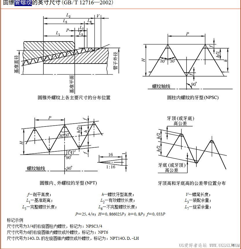

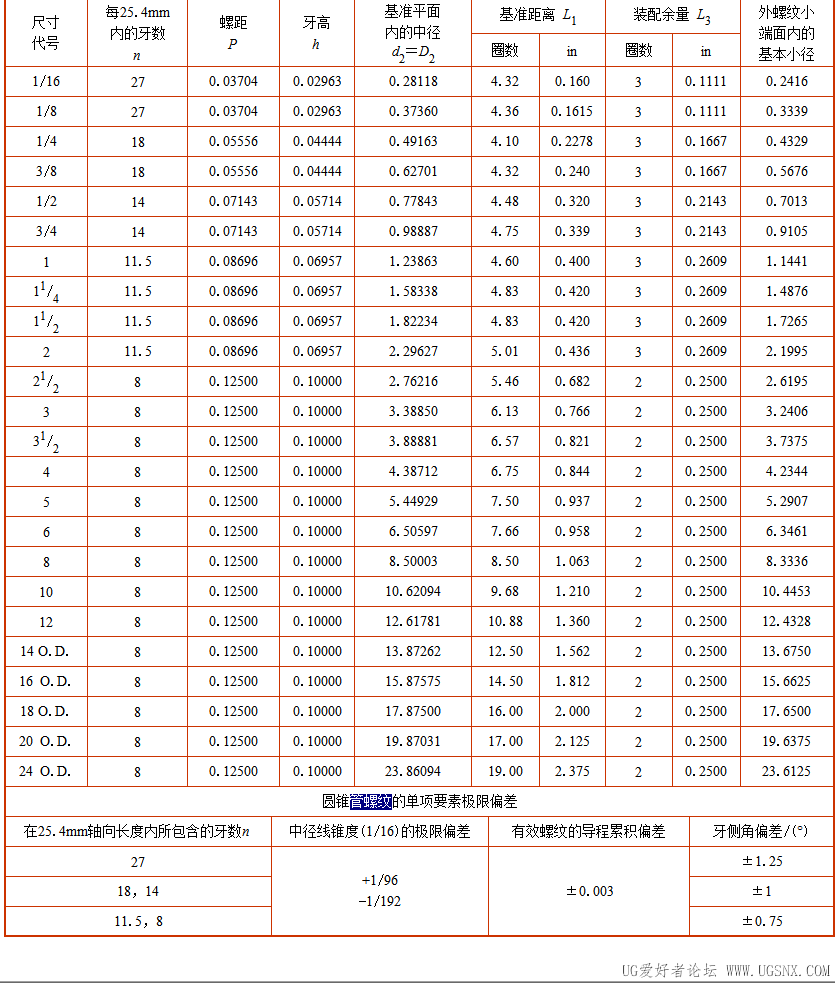

谁有英制&美制锥管螺纹的尺寸规格表,多谢!
241
2308
7930
7930
发表于 2026-3-19 13:22:00 | 显示全部楼层
NPT螺纹(美制管螺纹)
https://www.ugsnx.com/forum.php? ... amp;fromuid=9700371
