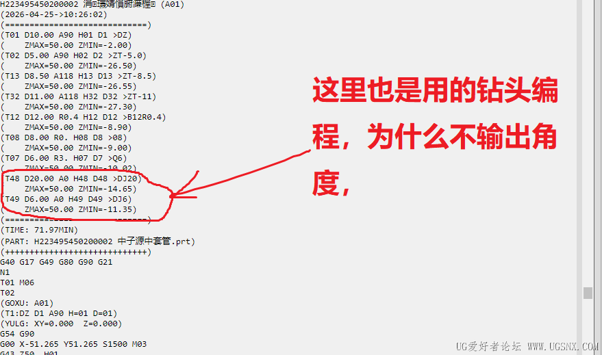

为什么我的后处理前面几把刀角度读取正常,后面的两把刀读取不到角度呢

#PB_CMD_TOOL_INFO
set outputthd 1
global toollist mom_tool_cutcom_register mom_cutcom_adjust_register mom_tool_name mom_tool_diameter mom_tool_corner1_radius mom_tool_adjust_register mom_tool_adj_reg_defined mom_tool_number mom_tool_type
global mom_tool_taper_angle mom_tool_point_angle mom_tool_lower_corner_radius
global mom_sys_max_travel mom_sys_min_travel mom_machine_time
global ptp_file_name ino mom_group_name mom_output_file_suffix mom_output_file_basename
set tdi [format "%.2f" $mom_tool_diameter]
# 安全读取角度变量(弧度转角度)
if {[info exists mom_tool_taper_angle]} {
    set angle_val [expr (180 / 3.14159) * $mom_tool_taper_angle]
} elseif {[info exists mom_tool_point_angle]} {
    set angle_val [expr (180 / 3.14159) * $mom_tool_point_angle]
} else {
    set angle_val 0
# 安全读取圆角变量(自动去尾零)
if {[info exists mom_tool_corner1_radius]} {
    set r_val [string trimright [format "%.2f" $mom_tool_corner1_radius] "0"]
} else {
    set r_val 0
if {[info exists mom_tool_lower_corner_radius]} {
    set cr_val [string trimright [format "%.2f" $mom_tool_lower_corner_radius] "0"]
} else {
    set cr_val 0
# 刀具号 / 补偿处理
if [info exists mom_tool_number] {
    set tt $mom_tool_number
} else {
    set tt 0
if [info exists mom_tool_adj_reg_defined] {
    set th $mom_tool_adjust_register
} else {
    set th 0
    set td $mom_tool_cutcom_register
} else {
    set td 0
set tt [format "%02.0f" $tt]
set th [format "%02.0f" $th]
set td [format "%01.0f" $td]
set hhh $th
# 按刀具类型自动判断:R / A(你的核心逻辑)
if {$mom_tool_type == "Milling Tool-T Cutter"} {
    set r $cr_val
    set rr2 "R$r"
} elseif {[string first "Drill" $mom_tool_type] != -1} {
    set angle $angle_val
    set rr2 "A[format "%.0f" $angle]"
} elseif {[string first "Chamfer" $mom_tool_type] != -1} {
    set angle [expr $angle_val * 2]
} else {
    set r $r_val
    set rr2 "R$r"
# 输出刀具清单文件(干净规整)
set tool_lists_file_name ${ptp_file_name}_toollists
if {![info exists ino]} {
    set ino 1
    if {[file exists $tool_lists_file_name]} {
        MOM_remove_file $tool_lists_file_name
set tfile [open $tool_lists_file_name a]
if {$ino > 1} {
    puts $tfile "(    ZMAX=[format "%.2f" $mom_sys_max_travel(2)] ZMIN=[format "%.2f" $mom_sys_min_travel(2)])"
set mom_sys_max_travel(2) -9999.999
set mom_sys_min_travel(2)  9999.999
if {$outputthd == 1} {
    puts $tfile "(T$tt D$tdi $rr2 H$th D$td >$mom_tool_name)"
incr ino
close $tfile

发表于 2026-4-25 20:00:53 | 显示全部楼层
我猜有可能是铣刀角度与钻头角度变量取的名称一样的原因,你可以分开取2个不同有名称试试,猜想,没试
