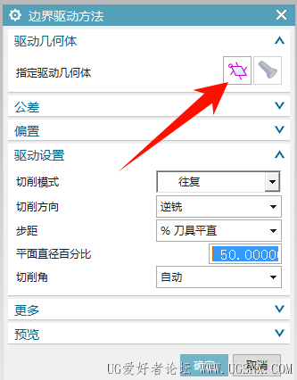

你好, 请问二次开发中, 可变轮廓铣, 如何设置边界驱动,下面是我写的代码, message返回信息是   Object is not the desired type    应该如何加进去
int count = 0;
        tag_t *objects = NULL;
        UF_UI_ONT_ask_selected_nodes(&count, &objects);
        int count1 =1;
        tag_t curves[1] = {45219};
        UF_CAMBND_boundary_data_t boundary_data;
        boundary_data.boundary_type = UF_CAM_boundary_type_closed;
        boundary_data.plane_type = 1;
        boundary_data.material_side = UF_CAM_material_side_in_left;
        boundary_data.origin[0] = 0.0;
        boundary_data.origin[1] = 0.0;
        boundary_data.origin[2] = 0.0;
        boundary_data.matrix[0] = 1.0;
        boundary_data.matrix[1] = 0.0;
        boundary_data.matrix[2] = 0.0;
        boundary_data.matrix[3] = 0.0;
        boundary_data.matrix[4] = 1.0;
        boundary_data.matrix[5] = 0.0;
        boundary_data.matrix[6] = 0.0;
        boundary_data.matrix[7] = 0.0;
        boundary_data.matrix[8] = 1.0;
        boundary_data.ignore_holes = 0;
        boundary_data.ignore_islands = 0;
        boundary_data.ignore_chamfers = 0;
        boundary_data.app_data = NULL;
        UF_CAMBND_app_data_t         app_data;
        app_data.has_stock = 0;
        app_data.has_tolerances = 0;
        app_data.has_feedrate = 0;
        app_data.has_blank_distance = 0;
        app_data.has_tool_position = 0;
        UF_CAMBND_app_data_p_t dates = &app_data;
        int err = UF_CAMBND_append_bnd_from_curve(objects[0], UF_CAM_drive, count1, curves,&boundary_data, &dates);

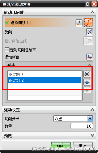

发表于 2026-6-4 07:47:52 | 显示全部楼层
需要的是这个吗,不是的话截个图发下吧

 楼主| 发表于 2026-6-4 09:14:21 | 显示全部楼层
不小明我们不约 发表于 2026-6-4 07:47
需要的是这个吗,不是的话截个图发下吧
您好,是这个边界驱动

发表于 2026-6-4 10:02:23 | 显示全部楼层
我把代码部分修改了下,增加了一些分配内存的功能,关键是UF_CAMBND_append_bnd_from_curve这里改成了UF_CAM_trim,不是UF_CAM_drive,我测试了下问题不大
                        int count1 =2;
                        int ErrCode;
                        tag_t* Curve_list = NULL;
                        Curve_list = (tag_t*)UF_allocate_memory(count1 * sizeof(tag_t), &ErrCode);
                        Curve_list[0] = 34254;
                        Curve_list[1] = 34253;
                        UF_DISP_set_highlight(34253,1);
                        UF_CAMBND_boundary_data_p_t boundary_data;
                        boundary_data = (UF_CAMBND_boundary_data_p_t) UF_allocate_memory(sizeof(UF_CAMBND_boundary_data_t), &ErrCode);
                        boundary_data->boundary_type = UF_CAM_boundary_type_open;
                        boundary_data->plane_type = 1;
                        boundary_data->material_side = UF_CAM_material_side_in_left;
                        boundary_data->origin[0] = 0.0;
                        boundary_data->origin[1] = 0.0;
                        boundary_data->origin[2] = 0.0;
                        boundary_data->matrix[0] = 1.0;
                        boundary_data->matrix[1] = 0.0;
                        boundary_data->matrix[2] = 0.0;
                        boundary_data->matrix[3] = 0.0;
                        boundary_data->matrix[4] = 1.0;
                        boundary_data->matrix[5] = 0.0;
                        boundary_data->matrix[6] = 0.0;
                        boundary_data->matrix[7] = 0.0;
                        boundary_data->matrix[8] = 1.0;
                        boundary_data->ignore_holes = 0;
                        boundary_data->ignore_islands = 0;
                        boundary_data->ignore_chamfers = 0;
                        boundary_data->app_data = NULL;
                        UF_CAMBND_app_data_p_t  *AppData;
                        AppData = (UF_CAMBND_app_data_p_t *)UF_allocate_memory( count1* sizeof(UF_CAMBND_app_data_p_t ), &ErrCode);
                        UF_CAMBND_app_data_p_t          app_data;
                        app_data = (UF_CAMBND_app_data_p_t ) UF_allocate_memory(sizeof(UF_CAMBND_app_data_p_t ), &ErrCode);
                        app_data->has_stock = 0;
                        //app_data->has_cut_stock = 0;
                        app_data->has_tolerances = 0;
                        app_data->has_feedrate = 0;
                        //app_data->has_offset = 0;
                        //app_data->has_avoidance_type = 0;
                        app_data->has_blank_distance = 0;
                        app_data->has_tool_position = 0;
                        AppData[0] = app_data;
                        AppData[1] = app_data;
                        //int err = UF_CAMGEOM_append_items(objects[i], UF_CAM_drive, count1, Curve_list,AppData);
                        int err = UF_CAMBND_append_bnd_from_curve(objects[i], UF_CAM_trim, count1, Curve_list,boundary_data, AppData);
                        char message[133];
                        UF_get_fail_message(err, message);
                        uc1601(message,1);
                        UF_free(boundary_data);
                        UF_free(AppData);

 楼主| 发表于 2026-6-4 12:35:32 | 显示全部楼层
不小明我们不约 发表于 2026-6-4 10:02
我把代码部分修改了下,增加了一些分配内存的功能,关键是UF_CAMBND_append_bnd_from_curve这里改成了UF_CA ...
设置成功了, 太感谢了.
