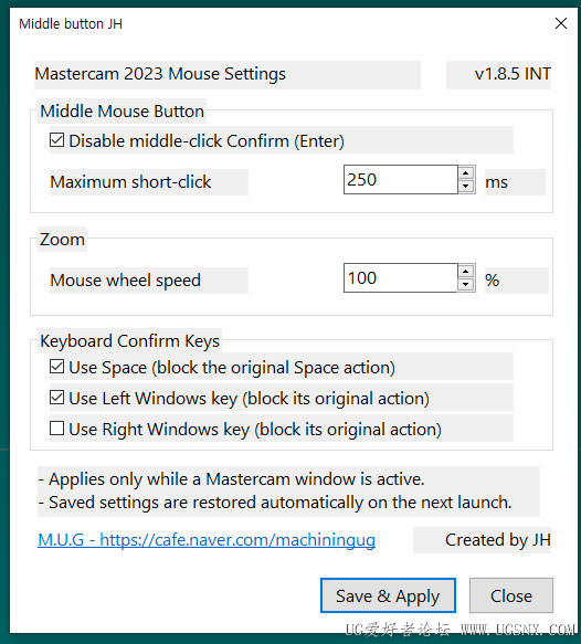

Middle Button JH is a lightweight C-Hook utility that improves mouse and keyboard confirmation controls in Mastercam.
Compatibility has been tested successfully with Mastercam 2021 through Mastercam 2027.
Key Features
- Short-click the middle mouse button to run Confirm (Enter).
- Adjust the middle-button short-click duration from 80 to 1000 ms.
- Adjust mouse-wheel zoom speed from 25% to 500%.
- Use Space, Left Windows key, or Right Windows key as a Confirm key.
- Enable each keyboard Confirm key independently.
- Block the original action of enabled keys only while Mastercam is active.
- Restore saved settings automatically whenever Mastercam starts.

Opening the Settings Window
1. Open Mastercam's Customize interface.
2. Find the "Middle button JH" category.
3. Run the "Middle button JH" command.
4. Select the desired options.
5. Click "Save & Apply".
The feature starts automatically when Mastercam loads the DLL. The command is only used to open the settings window.

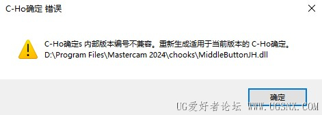

哪里不对,不是运行加载项嘛?
搞定!

sanshi80 发表于 2026-8-16 16:10
哪里不对,不是运行加载项嘛?
搞定!
1. 请将 **`MiddleButtonJH.dll`** 和 **`MiddleButtonJH.ft`** 完全删除后重新安装。
2. 请在 **Mastercam 2024 的整个安装目录** 中搜索,确认是否存在重复的 **`MiddleButtonJH.dll`** 或 **`MiddleButtonJH.ft`** 文件。
3. 如果还残留旧版本的 **`Mastercam2023MouseControl.dll`** 或 **`Mastercam2023MouseControl.ft`**,请将其删除。
4. 请确认 **Mastercam 当前实际使用的 DLL 文件的 SHA-256 哈希值**,并把结果发给我。
5. 请确认并告诉我 **Mastercam 2024 的准确版本号(Build / Update 版本)**。
