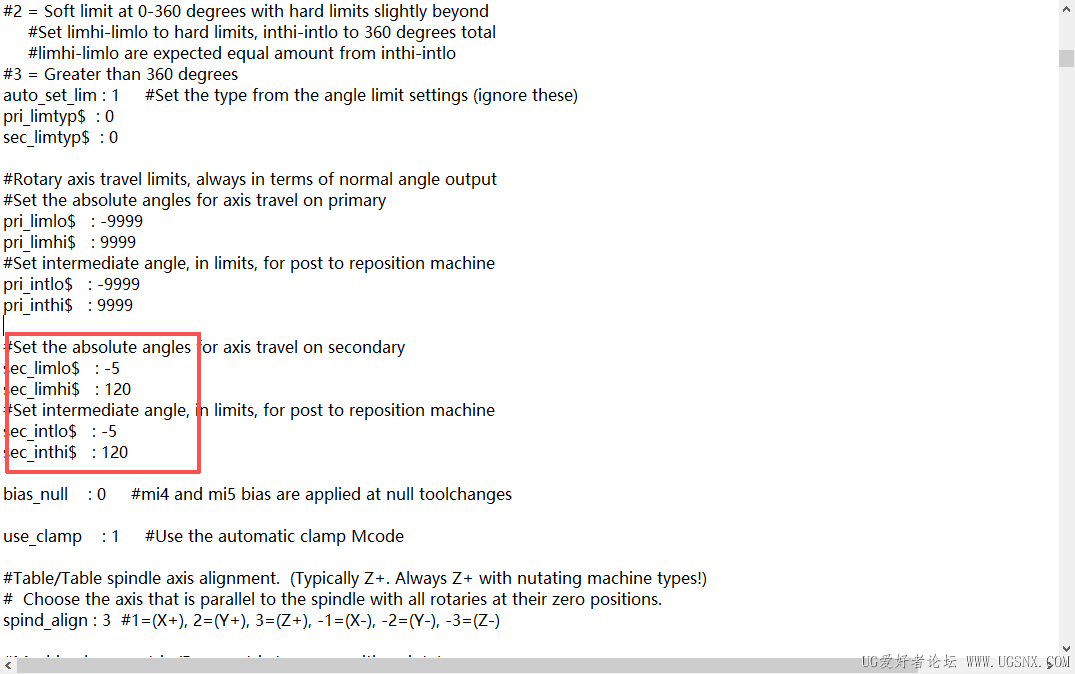

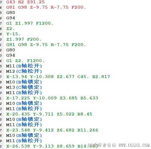

我这后处理是3+2转台的,3+2转台B往左倾斜为B正,现在后处理出来多是B负,能帮我改成走B正数吗,负数给限制到B-5然后就不能再负了,谢谢各位大佬

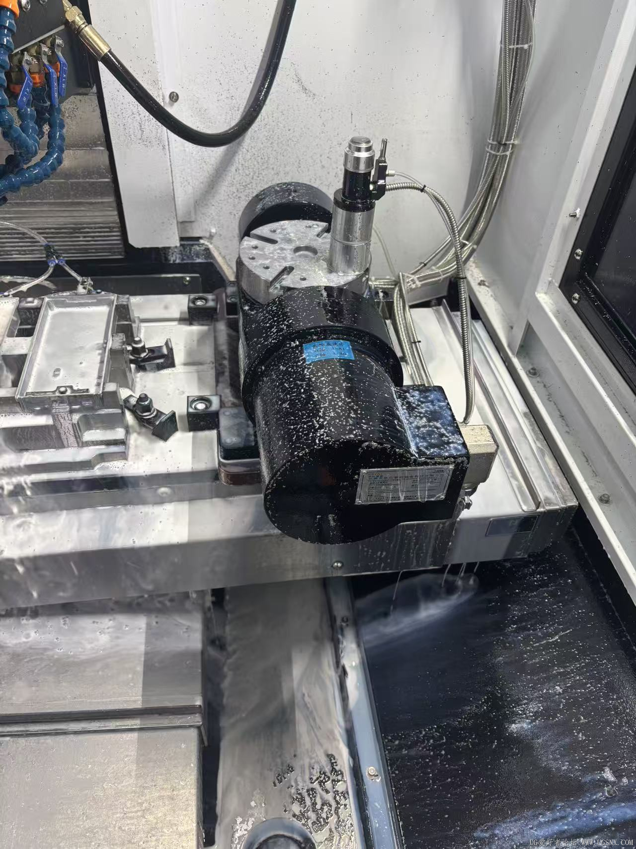

 楼主| 发表于 2026-8-19 13:56:17 | 显示全部楼层
邱恒生 发表于 2026-8-18 14:57
这对刀仪装这里玩呢
对刀仪是做三轴货,没地方放临时放上去的   谢谢大佬

发表于 2026-8-18 14:57:37 | 显示全部楼层
这对刀仪装这里玩呢

发表于 2026-8-18 14:55:49 | 显示全部楼层
#Primary axis angle description (in machine base terms)
#With nutating (mtype 3-5) the nutating axis must be the XY plane
rotaxis1$ = -vecx  #Zero
rotdir1$  = -vecy  #Diretion
#Secondary axis angle description (in machine base terms)
#With nutating (mtype 3-5) the nutating axis and this plane normal
#are aligned to calculate the secondary angle
rotaxis2$ = vecz  #Zero
rotdir2$  = -vecx  #Direction
这里的修改

发表于 2026-8-19 19:32:33 | 显示全部楼层
你把他吓一跳了
