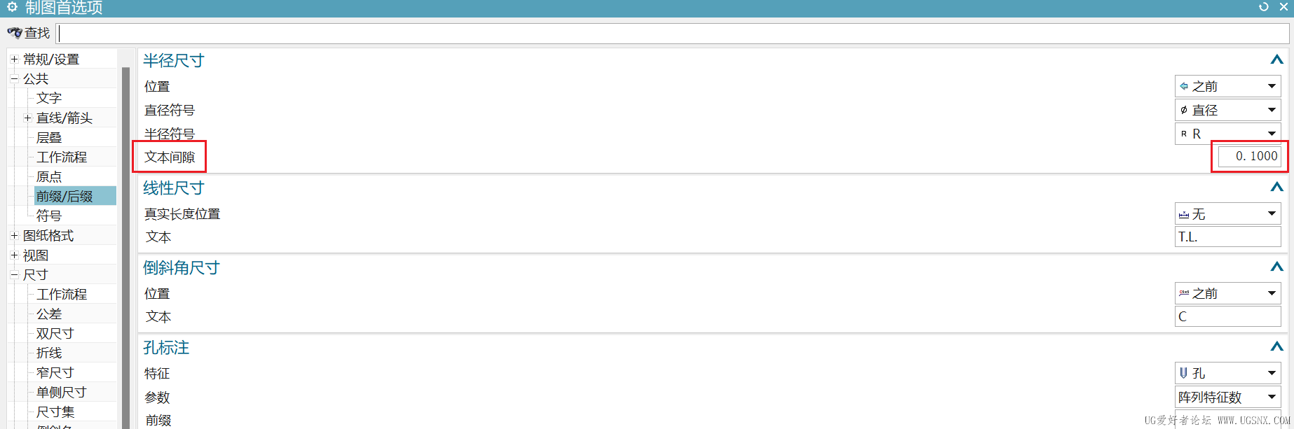

[求助] 如何调整前后缀附加文本与尺寸线之间间隙?1240前面的直径符号,794后面的文字

解答:
修改ugii_env.dat,查找“DRAFT_DIM_APP_TEXT_SPACING,将这个变量
前的“#”号去掉,将值改为“0.1”(或比原值“1.0”小的数)DRAFT_DIMAPP_TEXT_SPACINGcontroTs spacing between before appendedtext and the next piece of dimension text to its right, and spacingbetween the afterappended text and next piece of dimension textto its left.This is a factor related to the appended text character size.

发表于 2026-4-3 11:04:50 | 显示全部楼层
可以在制图首选项中修改
首选项-公共-前缀/后缀
