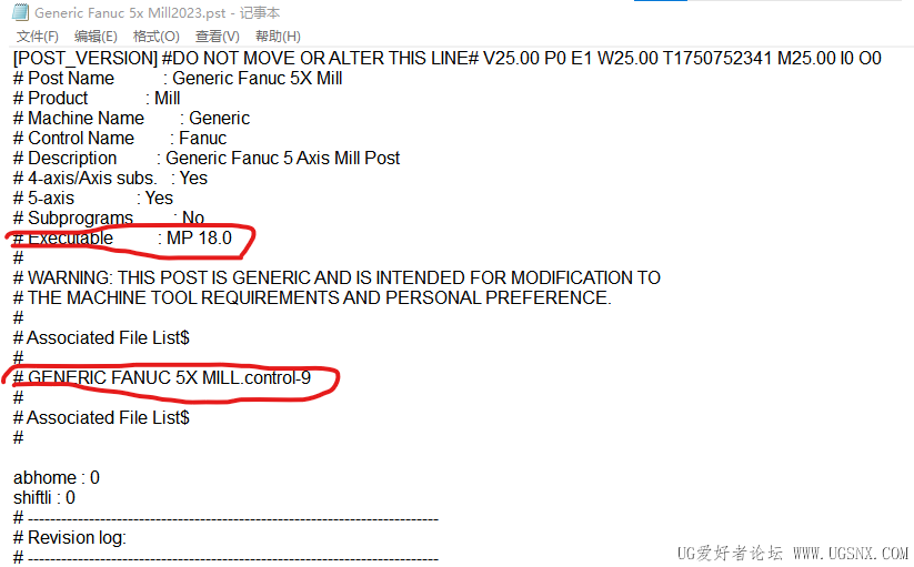

 楼主| 发表于 2025-12-16 15:11:26 | 显示全部楼层
能看看里面内容吗,是不是用户升级的

发表于 2025-12-16 23:43:10 | 显示全部楼层
HELLO555 发表于 2025-12-16 15:11
能看看里面内容吗,是不是用户升级的
[POST_VERSION] #DO NOT MOVE OR ALTER THIS LINE# V25.00 P0 E1 W25.00 T1641593926 M25.00 I0 O0
scncpost_revision     := "25.84" # Internal revision number for use by CNC Software only.  Please do not change this number.
scustpost_revision    := "0"  # Revision number for use by Resellers or customers.
# Post Name           : Generic Fanuc 5X Mill
# Product             : Mill
# Machine Name        : Generic
# Control Name        : Fanuc
# Description         : Generic Fanuc 5 Axis Mill Post
# 4-axis/Axis subs.   : Yes
# 5-axis              : Yes
# Subprograms         : No
# Executable          : mp.dll
# WARNING: THIS POST IS GENERIC AND IS INTENDED FOR MODIFICATION TO
# THE MACHINE TOOL REQUIREMENTS AND PERSONAL PREFERENCE.
# Associated File List$
# GENERIC FANUC 5X MILL.MCAM-CONTROL
# MILL 5 - AXIS TABLE - HEAD VERTICAL.mcam-mmd
# MILL 5 - AXIS TABLE - HEAD VERTICAL MM.mcam-mmd
# MILL 5 - AXIS TABLE - TABLE HORIZONTAL.mcam-mmd
# MILL 5 - AXIS TABLE - TABLE HORIZONTAL MM.mcam-mmd
# Revision log:
# Programmers Note:
# CNC 07/09/05  -  Initial post update for Mastercam X.
# CNC 06/26/06  -  Initial post update for Mastercam X2.
# CNC 11/02/07  -  Added prv_shftdrl$ = zero
# CNC 08/05/08  -  X3 release - no changes made
# CNC 03/05/09  -  Initial post update for Mastercam X4
# CNC 05/06/09  -  Modified rotary axis clamping
# CNC 06/18/09  -  Correct the can text order of Stop and Ostop
# CNC 02/03/10  -  Initial post update for Mastercam X5
# CNC 11/08/10  -  Added fix for X coolant output
#               -  Removed CD_VAR variables
#               -  Added fix for 5-axis drill cycle reference output
# CNC 02/17/11  -  Added arctype$ initialization to correct helix and full arc output when using R or signed R
# CNC 03/31/11  -  Added tooltable output option (see tool_info initialization) and header output
#               -  Added unclamp in protretinc if frc_cinit & use_clamp are enabled
# CNC 05/20/11  -  Initial post update for Mastercam X6
# CNC 07/24/12  -  X coolant 'With' - separated coolant 'with' logic from cantext 'with' logic to give
#                    more control over output location of X coolant 'With'.  See pcan1 and pcan1_cool
# CNC 10/16/12  -  Initial post update for Mastercam X7
# CNC 02/06/14  -  Initial post update for Mastercam X8
# CNC 12/23/14  -  Initial post update for Mastercam X9
# CNC 11/09/15  -  Initial post update for Mastercam 2017
# CNC 09/28/16  -  Removed call to pclamp from ppos_cax_lin to remove unwanted unclamp & clamp codes around rapid moves produced by brk_mv_head
# CNC 10/14/16  -  Initial post update for Mastercam 2018
# CNC 03/31/17  -  Beginning with Mastercam 2018, all post text edits MUST be made with the Control Definition Manager.
#                  Do NOT edit the post text manually.
#               -  For Mastercam 2018, only ANSI text is supported. The UTF-8 tag is still required in 2018 and should not be changed.
# CNC 04/24/17  -  (20.80) Initial revision number assigned.
# CNC 09/13/17  -  (21.80) Initial post update for Mastercam 2019
# CNC 04/05/18  -  (21.81) Added another option to use_tlength (3). Allows user to enter just the length of tool, and have post add
#                  the dist to pivot center to calculate pivot to tool tip. See use_tlength & pvt_to_spdlface.
# CNC 07/20/18  -  (21.82) Added new logic for tool inspection and logic to stop and restart spindle\coolant at inspection point (see ptool_insp)
#                  Note: All 5 axis paths delay the inspection point until null toolchange for safety.
# CNC 02/14/19  -  (22.82) Initial post update for Mastercam 2020
# CNC 01/10/20  -  (23.82) Initial post update for Mastercam 2021
# CNC 07/06/20  -  (23.83) Corrected the plunge feedrate being used for drilling after reposition.
# CNC 09/17/20  -  (23.84) Corrected issue of feedrate zero output.
# CNC 01/11/21  -  (24.84) Initial post update for Mastercam 2022
# CNC 01/10/22  -  (25.84) Initial post update for Mastercam 2023
1206489254
@qq
.com
