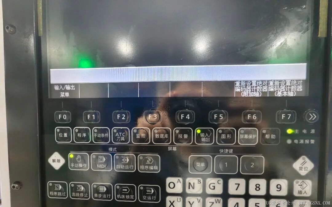

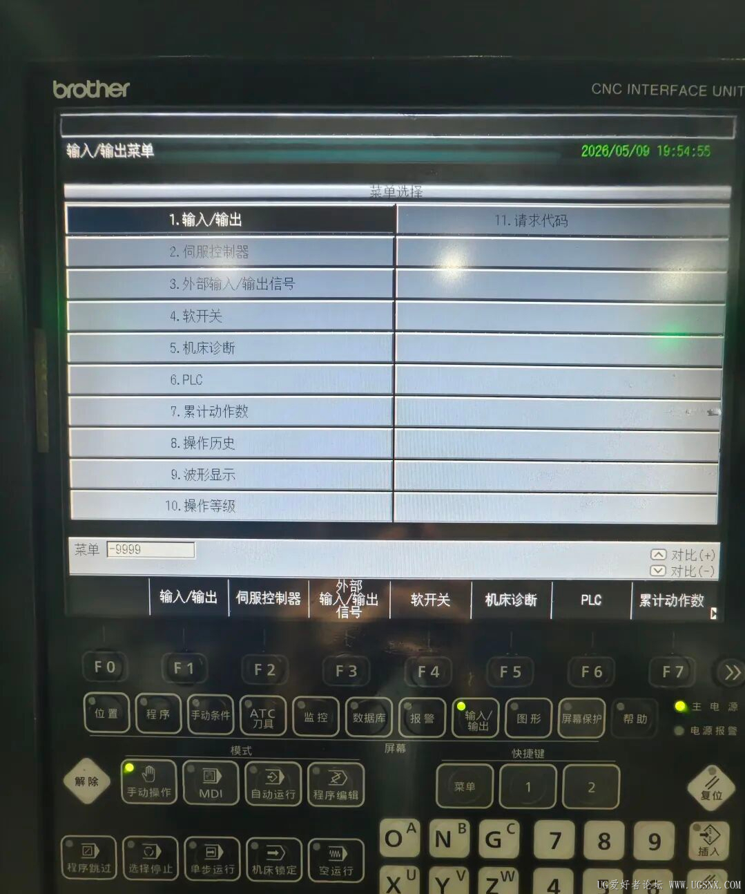

①输入/输出→在对话框里输-9999

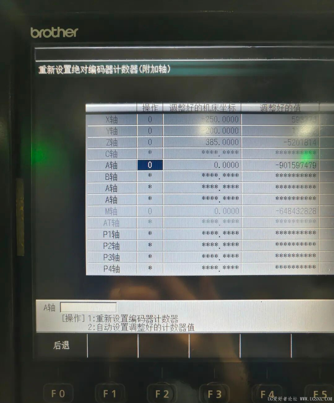

②按有"附加轴"那个按扭
③光标置A轴,先1→后2→ok
