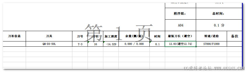

发表于 2026-9-13 00:34:29 | 显示全部楼层
2026-09-13_002530.png 2026-09-13_002543.png 棒棒糖刀好像检测有问题
